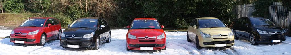

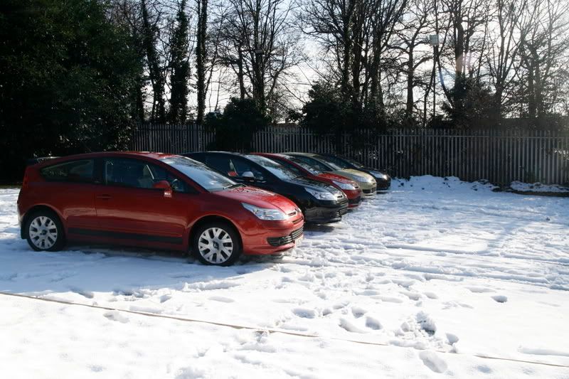

I have very few photos of the car unfortunately
Can see it here as well though. Was from a little meet we had a Cituning when we had lots of snow.

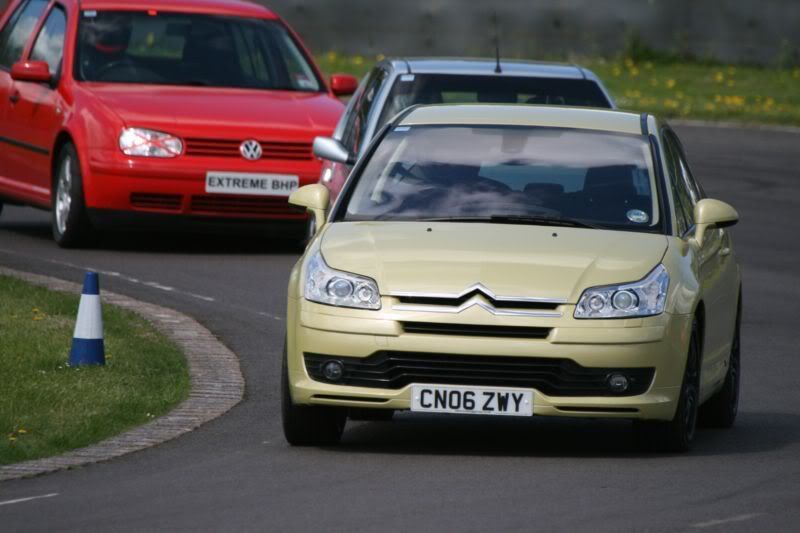

Also have some pictures of it on another track from a couple months ago.
Can see some more pictures below as well as a couple friends cars one of which is a C4 VTS 2.0 HDI with 170CV. Also soon to be putting out over 200CV.

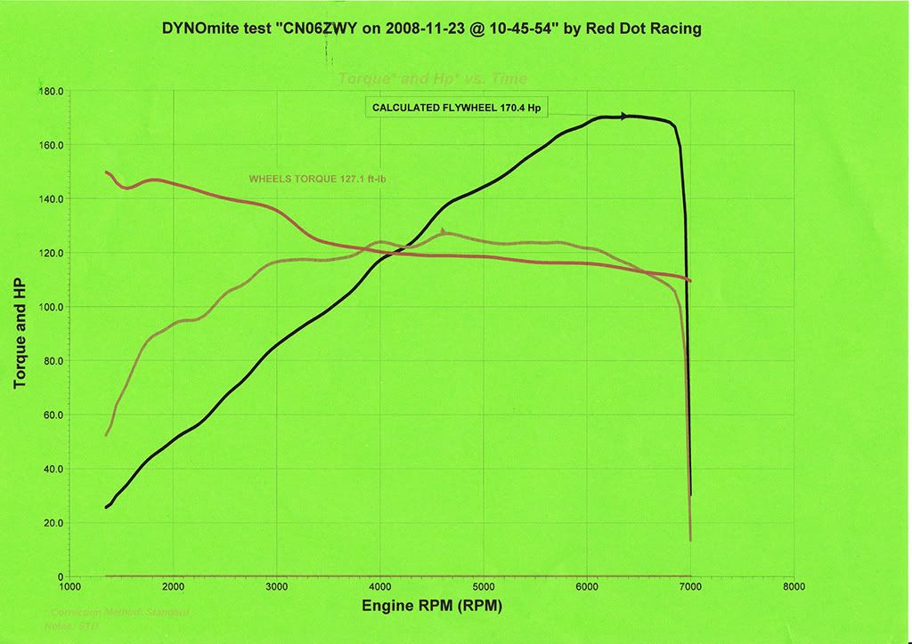

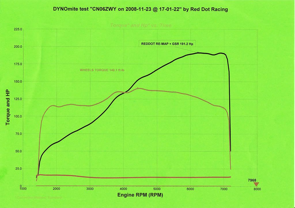

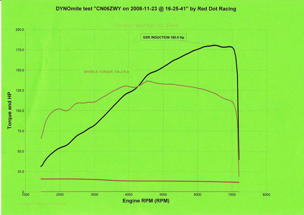

Filter gained 10Cv, Chip gained another 11CV taking it from 169cv to 191cv.
Full rolling road details for you.
Stock
Filter
Filter and chip
And comparison between 1st run and the last run on the day.
All done on the same day at the same rolling road. CV is done as a calculated figure. Torque is measured at the wheels. So torque is actually around 170 ft lbs when you work out it should be the same as the power is at 5252RPM.
